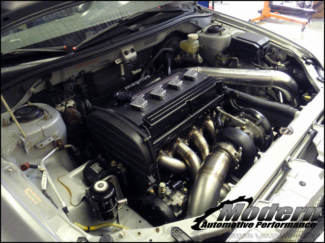

Специально для почитателей стэндэлоунов: Build Details MAP Stage 2 2.4L Shortblock - OEM 100mm Crankshaft - MAP SpecWiseco HD Pistons - ACL Race Bearings - MAP Rods MAP Stage 5 Cylinder Head GSC S3 Camshafts GSC Valve Springs & Retainers Fidanza Cam Gears Precision Turbo Billet Ball Bearing Turbocharger Speed Density with AEM 5 Bar Sparktech Coil on Plug AEM CDI Ignition Box / Wideband / Gauges ETS 5" Front Mount Intercooler Fuel Injector Clinic 2150cc Injectors (E98 Fuel) Magnus V5 Cast Intake Manifold & Fuel Rail OEM replacement parts supplied by mitsubishiparts.net QuarterMaster Twin Plate Clutch (2010 Revised Version) Torque Solution Motor Mounts Mishimoto Aluminum Radiator Turbosmart Raceport BOV / 45mm Wastegates / eBoost2 / AFPR http://www.youtube.com/watch?v=eo03RWg6BCY http://forums.evolutionm.net/evo-dyno-tuni...p+stock+evo+ecu
я правильно понял что онм мотор на стоковом колене 100мм крутили до 9500 оборотов?
